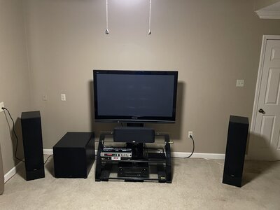

Before replacing the center channel, I’m attempting a quick fix. The tweeter dome and diaphragm didn’t appear damaged but what was left of the ferrofluid was a thick sludge. I cleaned all of the old fluid out and replaced it with a vial of new fluid from Parts Express. Everything came apart and went back together very easily. I haven’t had a chance to calibrate my speakers for the new room or even see if the tweeter passes sound but I did manage to get everything in the front of the room in place.
Here’s what it looks like so far.
Looks very nice. May I make a suggestion? Pull the mains further away from the wall and increase the distance between them as much as you can. I dont know what us behind your chair or your room dimensions. Have you tried orienting your system towards the middle of the long wall (left wall in your picture) ?
That picture was taken 6 months ago right after I moved and was still setting everything up. A few days after I took that picture, I spaced the mains apart, towed them toward the listening position, and placed the sub between the center and left front. That removed quite a bit of boominess from my sub. The rest was tamed with a parametric EQ giving me a nice flat response.
The wall to the left is a big window covered by thick blackout curtains. Same with the wall behind the listening position. It’s difficult to see in the picture but the tv is centered in the best possible location in the room.
Sound in the room is fine, especially after replacing the 20+ year old receiver and amp with a new receiver.
