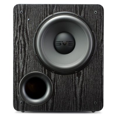

The new 2000 series of 12-inch subwoofers from SVS features their new Sledge STA-500D amplifier with DSP controls, boasting 500 watts of power and distortion-free performance. The subwoofers come in a sealed (SB-2000) and ported (PB-2000) design. SVS sent samples of these new products for Home Theater Forum to evaluate, and our review is in.
SVS SB2000 & PB2000 Subwoofers Review

Currently, what may be the weakest part of my home theater is my subwoofer, the OSD PS10 (which I reviewed in 2011). And that is my baseline when comparing the SB2000 and PB2000 subwoofers from SVS. For home theater use, the connections and settings for both the SB2000 and PB2000 are simple and identical. Simply connect one subwoofer cable from the LFE Pre-out on your receiver to the Right Channel input on the subwoofer (which is also marked as LFE). Set the volume to 50% (12:00), leave the phase at 0, and rotate the low pass filter to LFE. Plug in the power, flip the switch from Standby to ON, and run the receiver’s calibration program. My Marantz SR5008 receiver did have some difficulty detecting an acceptable level for both the SB-2000 and PB-2000, and per the recommendation of SVS tech support, they suggested running the calibration again, but setting the volume on the subwoofer to 1:00 or 2:00, then adjusting the volume back to my own personal preference. The Audyssey program on the Marantz suggested crossovers of 60Hz for the fronts and 40Hz for the Center and Surrounds. The detected settings were identical between the SB-2000 and PB-2000.
Rear view of SB-2000​
Rear view of PB-2000​
SB-2000
Front view of SB-2000 without grill​
Specifications:
[*]New SVS 12” 2000-series driver
[*]New Sledge STA-500D DSP amplifier, 500 watts RMS (1100 watts peak dynamic)
[*]Premium black ash finish
[*]Protective non-resonant steel mesh grille
[*]Rigid and braced MDF cabinet
[*]19-220 Hz ±3 dB
[*]FEA-optimized motor technology for low distortion.
[*]Heavy-duty 2” voice coil for extreme power handling.
[*]Upgraded Nomex spider for improved linearity and driver control at extreme drive levels.
[*]500 watts RMS continuous (1100 watts peak dynamic), Class D power with 'green' (
