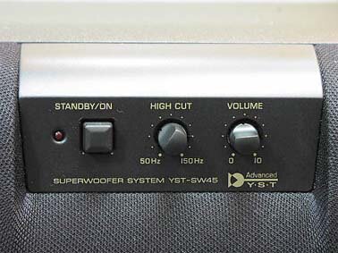

Some addition questions, if you don't mind. With the above-described amplifier setup -- 5.1 surround cube arrays with bass module AND Yamaha bookshelf speaker pair wired to Front B (for bigger front sound) -- I have lying around additional unused Yamaha YST-SW45 powered subwoofer and a few more Yamaha bookshelf speakers. Rear connections and front panel of the SW45 shown further below.
Q4: Can I add this powered subwoofer and perhaps additional speaker pair to this A/V setup? The receiver has both Multi-channel subwoofer and Pre-out subwoofer connections. The Bose bass module is currently connected to the single Pre-out subwoofer input. Does it matter which subwoofer connection on the receiver is used? I've had the bass module connected to both in the past. I have an owners setup manual pdf, but wanted to check here first before attempting anything. Just trying to maximize setup with what extra equipment I have around the house.

Q4: I don't see a multi-channel subwoofer connection (I do see a multi-channel input, but that's not useful for your scenario).
The Bose base module should be connected to the primary powered outputs. The powered sub could be connected to the sub pre-out (I would do this). You could add the other speakers if you're going for volume; but if the goal is a tuned system the added speakers will probably just be turned down during auto-calibration. (The B channel is not generally meant for use in the same room as the A channel at the same time.)

I've found using both A and B channels in my setup works pretty. Provides a slightly bigger front sound than the cubes provide by themselves, and blend in nicely. I don't listen at blow-out volumes anymore. Too old.
I'll probably try the powered subwoofer at some point and see how it mixes in.
