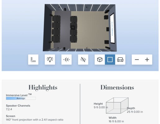

Well we are slowly making progress . Here is sketch do the design
As some of us pointed out early on, looks like you're setting the seats too far away (at 17ft) from the screen and could likely also use a bit more space behind the back row (for likely better acoustics). For a 140" screen (even if, or maybe especially if, 2.4:1 for CIH), I'd probably suggest somewhere around 12-14ft viewing distance for the front row -- that means having that row of seats be ~10-12ft away from the screen. Personally, I'd go for the shorter distance, especially if going 2.4:1 for CIH, which will have a substantially smaller image for a majority of content that aren't 2.4:1 (or wider)... unless you really only intend to watch wider AR content for the vast majority of viewings -- even if you do that, I'd still prefer the shorter distance myself, especially for the front row...
And also realize that the viewing distance will be another 5ft-plus farther for the back row w/ how you have it -- that's pretty substantial... unlike in a real theater where everything else is much bigger (and 1 or 2 extra feet isn't a big deal)...

I wasn’t looking to do an AT screen because I have read that the picture isn’t as good as a traditional screen. This is a better representation of where the speakers are going to be placed. As you can see the fronts are not in front of the screen, just the subs are. I was planning freestanding speakers for the front, center and main surround. Then in wall/ceiling for the rest. First row is about 16ft from the screen. The construction costs are a lot more for building in the speakers vs freestanding and I was trying to save where I can. I am looking to have some calibrate the system once it installed.

IF you really don't want to go w/ AT screen setup, then I'd recommend moving the seats substantially forward/closer to the screen and front speakers than you have it.
Right now, you basically have viewing distance as ~16ft for the 1st row (and the speakers roughly ~14ft away)... and ~23ft for the 2nd row. Those are very long distances and kinda almost completely defeats the point of going 4K and FP. PLUS that setup will most likely not be optimal for the audio either.
I would move the seats at least another 2-4ft closer to the screen (and front LCR speakers) *and* probably also go for less spacing between the 2 rows unless you have some specific reason for what looks like >3ft legroom between rows.
After moving the seating (much) closer, I would probably also swap the front LR speakers w/ the subwoofers so the subwoofers would be the ones in the corners instead. Also, probably move the front LR speakers an extra foot or two away from that front wall (where the screen is). The front LR speakers will image better farther away from all walls while the subwoofers will likely benefit from the corners helping sub-bass, particularly for such a large room -- heck, you could probably even add another subwoofer or two along the rear wall...
_Man_

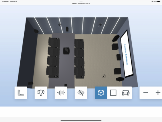

I completely agree with Man. Having the L&R speakers against the side wall is bad for imaging, but that's usually an ideal location for the subs. I would put the L&R speakers as close to the screen sides without blocking it.
AND...
I keep seeing designs with the seating too far from the screen and up against the back wall. This is also bad for immersion. You want to avoid being close to any speaker as much as possible. I would move the seating 4-6 feet forward and put the subs in opposing corners instead of both in the front. What I mean is have the subs in opposite corners of the room. Either front right and back left corners or front left and back right corners. This generally gives the most even distribution throughout the seating area and the fewest room interactions. When it's done properly with excellent subs, they will disappear into the room. I know all this seems counterintuitive, but it will yield the best results.
Also, the Atmos speakers should be further out into the room. They should be overhead, not high and off to the sides. I'd move the rear surrounds closer as well.

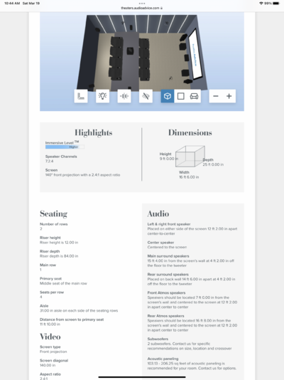

Thanks Man and John. So something more like this. I’m just using the Audio Advice tool to help w placement/visualization. It will not let me chose the sub locations or move the speakers. Wouldn’t moving the seats closer increase eye fatigue? I thought the benefit of being farther back was that you did get the tennis movement (moving head/eyes side to side to see the whole screen) in watching movies. I checked out the Kaleidescape. Looks cool and the picture is great. I just have to decide if we are moving away from physical media since we have a huge DVD/BR collection.

Where do you generally prefer to sit in a good theater w/ good large screen? All the way in the back row? Back 1/3? Front or rear of middle 1/3? Unless you generally like the back 1/3 instead of somewhere in the middle 1/3 (to get good immersion), that should not be a problem at all.
IF you're still concerned about eye fatigue from the "tennis movement" effect, I suggest you spend more time checking out similarly large (projected) screens from similar distance to help decide. And then, maybe just start w/ a smaller screen rather than have your seating farther away. It's probably much easier to upgrade to a larger screen later than reconfigure the whole rest of your atmos-capable HT setup (to move the seating, etc and still yield optimal sound). Just make sure the placement of the PJ will still allow going upto a 140" screen, ie. try to make sure it's set up to definitely be w/in the throw (and zoom) range (along w/ whatever needed lens shifting)... although that might not be possible for CIH setup, particularly if the screen size upgrade will be great enough (since you're already needing some of that zoom range to handle the CIH projection)... and of course, upgrading screen size w/out moving the PJ might not be optimal for other reasons (like optimal brightness)...
Also, if it feels a bit much at first, you'll likely adjust over time and could always start by watching from the back row first -- your back row is definitely still quite far from the screen w/ viewing distance of ~19ft w/ this new config.
Also remember you're going w/ a 2.4:1 CIH setup. All narrower content, which might be the (large) majority will look smaller.
Finally, move those rear surrounds a couple feet closer together away from those corners -- they should probably line up better w/ the front LR speakers. For the subs, if there's some problem w/ that software, I guess just make a note for yourself to place them differently in actual deployment -- and definitely consider John's recommendation re: sub placement (for one in the front and one in the rear)...
