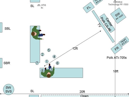

My 9.2 system is used for 100% movies, and I'm listening to ATMOS demos while focusing on the spatial location corresponding to the video. For example, the ATMOS "Leaf" demo has the sound circling the listener. I get a reasonable sound location behind the listening position, but the front right disappears, and it is weak at the front. The speaker layout is shown in the attached diagram, and the right side of the room is open. I understand it is a terrible Home Theater room and layout, and it will not be possible to change the TV location or add room treatments. It is also not possible to add ceiling height speakers as it's a cathedral ceiling. Of all the Audyssey settings I've tried, setting to Flat made the most significant improvement.
Do you have any suggestions to improve spatial sound accuracy?
I can add two more height speakers, but these would not be able to be mounted on the ceiling.
The system is a Denon AVR-X4500H with seven speakers, two height speakers (heights are above the Left and Right speakers on the wall), and two subs. I calibrated the room with Audyssey.
