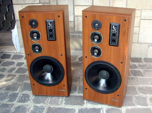

so, i understand the basic tricks given to speaker rating (peak power vs RMS), but recently i have learned a lot about amp scams and dont know what to believe about speakers anymore.. EX: I thought when an amp says 110Watts per Channel it really meant 110WPC... however when i looked at the power consumed it only uses 250Watts, i ran that through the 88% rule, and divided by 7 channels and am only getting 32WPC! That just blows me away that the numbers can be so fudged. So my question is this... I use a pair of Infinity SM 155s which are 'rated' for 300RMS each.. that cant be right.. they make my ears bleed at 110WPC (250W amp using only front 2 channels) and with entire 7.1 surround (32WPC) they still sound KILLER! There's no way they sound that good at only 10% of their power. can anyone explain to me why and how these numbers work?? How much power can they truly handle? is there a good formula/ test i can run?? Thanks in advance guys! Andrew

The speaker rating is how much the speaker can handle, not how much it needs. What is the 'sensitivity' of the speakers? That number will give you a better idea how loud you can play them. The higher the number, the easier it is to drive them, the louder they can play. Check out this article from Axiom Audio for good primer on amp and speaker power.

Speaker ratings are PEAK, unclipped, before something in the speaker fries. That rating has NOTHING to do with the amount of power required to give you adequate sound levels in your room.

And that's not a musical rating. They find RMS with a sine wave. Normally it is at 1,000 hz. If you sent 150w at 10zh into that speaker you would completely destroy the woofers even though they supposedly can handle it. Ignore the speaker and amp power ratings. Get quality speakers and a quality receiver and they will work together.
