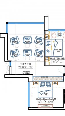

I wanted to have free standing speakers also, but the room layout is such that I am unable to move the screen ahead without blocking the entrance - I have attached a rough layout.
