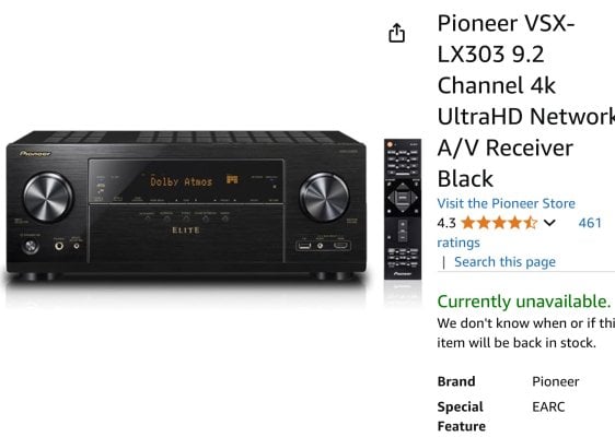

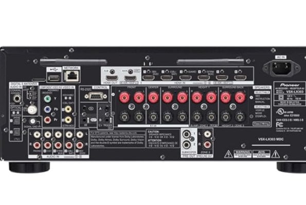

I'm considering to buy a Pioneer AVR (VSX 534) And, I was wondering why there aren't many reviews or talk on Pioneer AVRs in the forum. Most of the members speak of Marantz or Denon or Yamaha. Is there something about the Pioneer AVRs that I'm missing? This will be the first AVR purchase and would like to understand various perspectives. Please help a newbie. Thank you.
I have had this receiver since May of 2020.
I have been very impressed with it. I only paid $450 (new) at the time. Bang for the buck it is very impressive (5.1.4).
The newest model near that price point is the LX-305. Which you can find on sale for $500 once and a while. It is currently $600.
