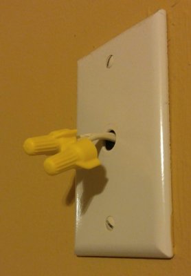

We moved into a house this year, and the previous owner had the living room wired up for sound. There are four spots with faceplates a few feet high on the wall that look like the attached photo, and then there's some loose speaker wiring behind where we hooked up the TV.

Those are basic speaker connections (and that's good for a quick setup; no external volume controls or such to worry about). Where do the other ends come out?
