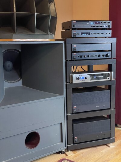

My next need was for a processor. Again, not wanting to spend multiple thousands of dollars, I did a little research (should have come here first) and found an Anthem AVM60 in tip-top shape for another $1000. It came from the dealer that originally installed it into a customer's system a few years ago and recently pulled it out for an upgrade. It hadn't been registered yet and he said he could warranty it for year. Coming from a very old-school system, I thought the features of the AVM60 were still light years beyond what I was used to. The AVM70 and 90s were going for much higher prices.
The Adcom 7805 and GFA565 monoblocks both have XLR inputs and the Anthem has XLR outs, so I now have 300W x 7ch of available sound. I also have a Crown XLS2500 and an XLS1500 amp for the subs. Both also have XLR inputs along with built in lowpass crossovers and volume controls.
For speakers I have a pair of Altec 604Cs in Stonehenge cabinets that were used in another system and facing another part of the house. I was thinking about just turning them around and using them as rear speakers.
I also have a pair of HiVi 3.1 Swan DIY speakers that I was going to use as surround left and right. They are smaller, but sound amazing.

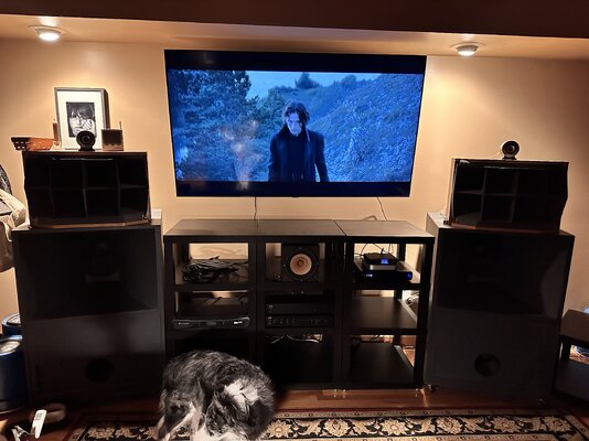

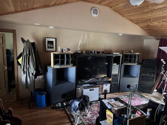

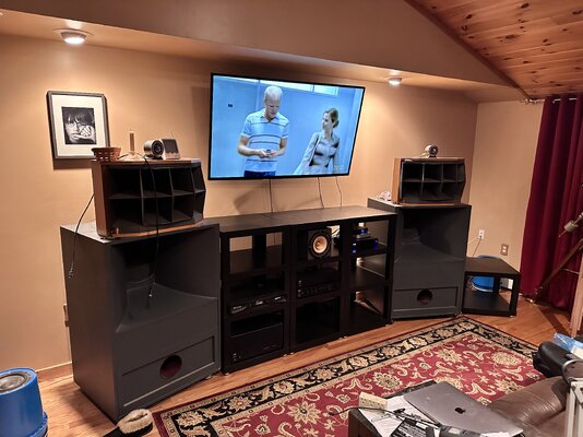

This was the disaster that was my old system. I should mention that I live alone...with Leo, the border collie in the last post. WAF is not an issue in this house!
I had a few days off during the Thanksgiving holiday and dismantled the old and built a new rack system with Ikea Lack tables.
And replaced the 60" TV with a 75"

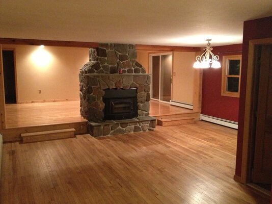

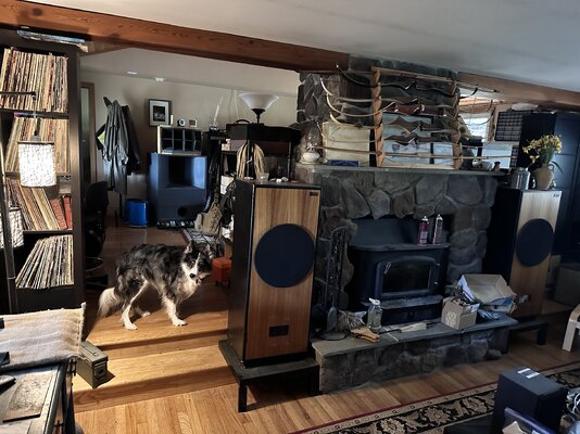

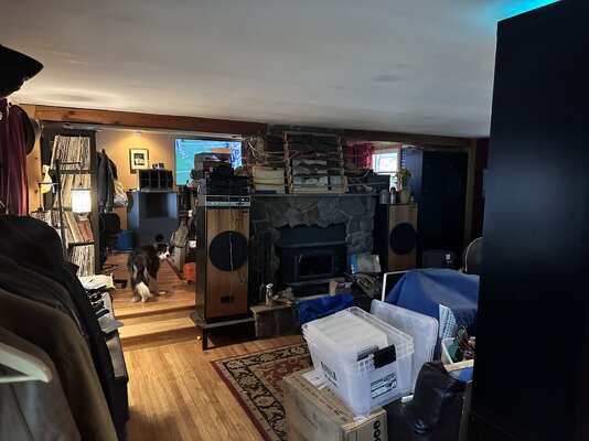

I envy the systems I have seen here and the rooms that they occupy. I wish I had that available to me. My house is a ranch built on a slab. No basement, but at least the area where the system is located is built on a raised wooden riser.
This was the space many years ago before I moved in:

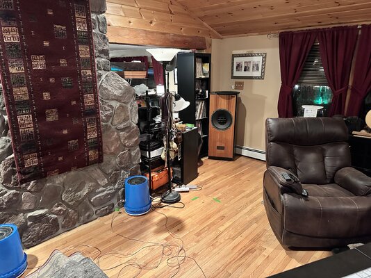

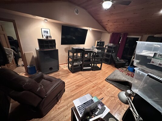

My listening chair is on the other side of the fireplace and the system is on the back wall. It is 20' wide and 10' deep. I know, not ideal.
This is the clutter now:

I took the whole room apart today.
Here's my 5.1 surround speakers:

Houston, we have a problem. I've been listening to this system for a few weeks and enjoying going through my movie favorites to see what they sound like in 5.1 (actually 5.4 as I have 4 subs). But I was going through some HT YT vids that were talking about the dreaded center speaker and it got me wondering. So when I got home tonight I started playing with settings and turning the center speaker on and off with the Anthem AVM60 and was stunned at how much sound was sucked out of the front Altec A5s when the center channel was turned on.
Yes, I am guilty of neglecting the significance of the center speaker and taking it for granted. The Altecs are 102dB efficient and I thought a single 8", full range, 96dB speaker in the middle would be good enough. To be honest, the sound coming out of the Tang Band is fine...it's the sound that gets diverted from the Altecs that is the problem. They sound totally anemic with the center channel turned and on heavenly with it turned off. I'm at a loss now to figure out a suitable center speaker that can hold its own dynamically with those 288 compression drivers and not block my TV. I might have to live with a phantom center channel and run 4.4 instead of 5.4. Or maybe there is a way to configure the Anthem to use the center speaker as just a fill instead of trying to carry the full weight.
