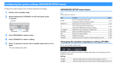

You're welcome, but Tino, you definitely do have the option in the Advanced Setup menu, which your model definitely does have. That's the menu where you go for firmware updates etc. The unit has to be in Standby mode to activate it. Try p103 of the manual, it's a little procedure to access the menu.
Edwin-S
Aug 20, 2000
9,847
Snips from Yamaha V581 user manual.
Method to access advanced set up.
Setting or checking mode.
Holy Shit!!!!
That did it!!!
Getting full 4K, HDR and 7.1
Thanks Craig and Edwin!!
You guys Rock!:thumbsup::thumbsup:
