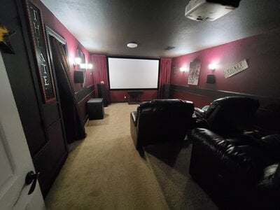

Hello, was hoping to get some insight into a possible upgrade. My current setup:
I have a dedicated, 100% light controlled room that is 16x24 with the hardware rack and server rack in a media equipment closet off of that room.
My current projector is an Epson 5030ub which is mounted on the ceiling at a distance of 16' from the 120" fixed screen. My front row of seating is approximately 14' from the screen.
My question is if I upgrade to one of the new 4K upscaled? Projectors, would I see a noticeable difference in picture quality? With my room configuration, would 4K be noticeably better?

In my opinion, the resolution (4K vs 1080p) doesn't make much of a difference, especially if you can't see the pixel structure now. HDR is the biggest upgrade when moving to 4K, and not all 4K projectors support that.

Exactly. But let's also be clear: in 2020 bulb based Projector HDR does not hold a candle to the best (OLED, FALD) panel HDR. It simply doesn't. Is there an HDR effect? Yes. But if you truly appreciate what HDR can do you will be as frustrated as the rest of us in these shortcomings. Is Laser up to the task? Maybe. But you still have the black end of the picture that doesn't match OLED.

I'm currently reviewing the Sony VPL-VW-995ES, a $30,000 laser projector. This is probably the first projector I've seen that does decent HDR, largely due to the laser light source. Even then, unless your room is totally light controlled with black velvet on walls and ceilings and a higher contrast screen, think below 1.0 gain or a gray fabric, it's still going to pale in comparison to any TV.
Now, to address the original question in the OPs post, I would not bother upgrading to anything that is not native 4K. One of the biggest benefits of going to a native 4K projector is that they have to use higher quality optics in the lens than they did in 1080p projectors, so you will see a noticeable improvement in MTF and overall image quality even if you can't see the pixel structure. I think the SMPTE recommendations for viewing distance to appreciate 4K are a little bit conservative, as I sit about 13 ft back from a 110-in screen, and can clearly tell the difference between 4K and 1080p picture.
Another reason to buy an HDR capable projector is this typically means the HDMI chipset can handle 10-bit color depth, which is a tremendous improvement over 8-bit. This is probably the biggest upgrade UHD brings to the table, and should not be underestimated. Content that previously had minimal banding will now be perfectly smooth, with no gradation. Often, you can also run 4K projectors in 1080p mode at 12-bit color depth with 4:4:4 chroma subsampling, which is another tremendous upgrade.

I'm not a projector person, but I do understand some of the dynamics involved in image reproduction, and I have to second what Dave has said. Simply approaching it from what projection is reasonably capable of. I seriously doubt any projector that's in a price range that a consumer will be remotely interested in will be able to do much if anything with the dynamic range aspect of HDR. Projection and high dynamic range simply don't go together very easily or at a reasonable cost. Color gamut (10 bit vs. 8 bit) is another issue, and is something you should be able to benefit from in a somewhat affordable projector.

I think you'd get a much bigger impact in experience by trying out ultra wide screens and anamorphic lenses instead.
