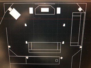

This is a rough layout of what I have. Right now I only have the two height speakers above the couch, not the other two. And The front wide speakers aren't there either. The scale of the speakers is probably in the ballpark also, but that's about it. Basement is finished except the ceiling, which is open floor joists of main floor above, painted black.

Incidentally, this is one of the most common mistakes with Atmos. Atmos speakers are intended to be overhead. Not just high and to the sides. So, they should be in/on-ceiling models, not bookshelf ones. Once again, there's lots of marketing claiming that high and to the sides is just fine, but it's a world away from what Atmos is designed to do. If you're going to go to the trouble of Atmos, I highly recommend taking it the extra step with overhead speakers.

Duly noted John, thanks. I did plan the placement to be directly overhead, as seen in the image of my setup in the original post, but I may very well have the wrong speakers to place in those spots. My "ceiling" though is open floor joists, not finished drywall, so I'm not sure how that will factor into what speakers I need.
