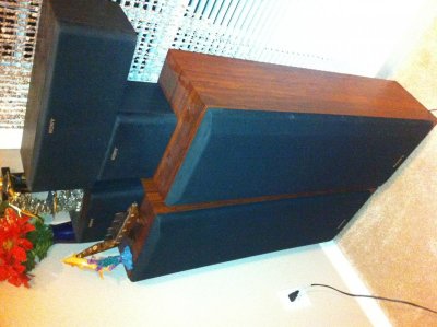

    I just got some free Sony speakers(Center - 66w/ Front 2- 50w/ Back 2- 200w) Now i am trying to complete my home theater system. someone told me that i cant under power the speakers. i dont know what else i need. need help...

    what are some good receivers that are out there now that can handle my speakers? and the output power i should be looking for?

    First thing you need to do is "ignore the power ratings". They, relatively, mean nothing...at all.
    A4L(already mentioned) has a bunch of AVR under $300. For your needs, you could get the Onkyo RC330(how do you get your Netflix?) if all you need is 3 HDMI.
    Occasionally the RC330 costs less on Ebay for the RC330 from A4L than it does directly on their website. Doesn't make any sense...but it happens. But since this is "budget"...I'd spend as little as possible on the AVR so you can get a better sub. BIC F12 is a great choice under $300.
