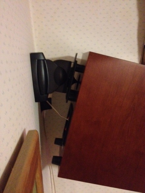

Here's a post of mine from a few years ago when I changed from tower speakers to wall-mounted speakers. The post contains a YT video of the speaker mounts I used. My walls are real plaster that are more than 100 years old. The installation was easy and four years later Polk Ri6's are still rock-solid. I used the same brackets to mount my rear speakers too.
Here's a picture from the next page of that thread--showing off the bracket:

And I just realized that you said the speakers you will be mounting are just 5 pounds. Those Polk RTi6s are nearly 17 pounds apiece!
Those brackets I used are just mounted in the plaster walls. No studs.
The industrial strength drywall anchors mentioned in that YT video were key to that process!

I just found the drywall anchors I used--purchased from Amazon. (Love their search engine on orders!).
So if you prefer the drywall locations for those speakers, those should give you the security of not worrying about that decision.

Holy crap those are cool. Watching that install video was very satisfying! Now I’m off to see if they’re available in Canada!
If you're talking about the video on the Amazon product page for the drywall togglebolts...they really ARE that easy. Hanging those brackets/speakers was one of the easiest DIY projects I've ever undertaken. The hardest part was getting those 17-pound speakers up to the bracket. :D That and cleaning up the plaster dust after drilling the holes. :laugh:
