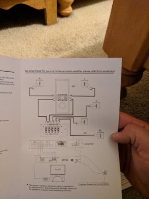

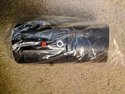

Sorry, but that doesn't make it look any better. The wiring diagram on the bottom left doesn't make any sense. Plus, their description sort of confirms some of my suspicions. They appear to have extremely small (2.5") full range drivers, but they call them "2 way" or '3 way" based on the number of drivers in the cabinet. That's just flat out lying. If you post a pic of the back of the bass module and one of the speakers, where the connections are, then I should see how everything connects and can give some guidance.

Here's the photos... definitely need an amp...but I'm confused on the sub.. shouldn't it be rca cables?

OK, that's what I was expecting. It's not a subwoofer, but a bass module, which is why it has speaker wire connections instead of an RCA. You can, and will probably want to add an actual, powered subwoofer that will connect to the subwoofer output on a surround receiver.
Don't expect much with these speakers. They're probably actually worth, at most, $50 for the whole set. So, like the printed wiring diagram (not the one on the box) shows, you run the center and surround speaker outputs directly to those speakers. Then, you run the L&R speaker outputs to the input on the bass module, and then out to the L&R speakers. The speakers won't be able to reproduce any bass at all. I mean NONE. So, the bass module is there to help with that a little.
