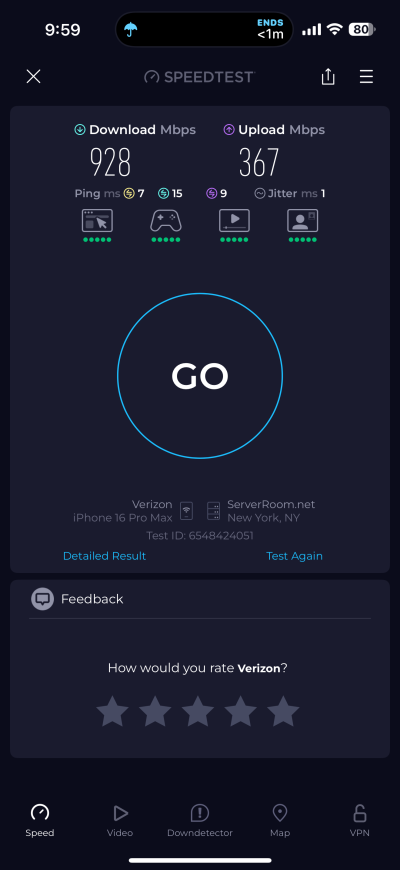

WOW!
I am going to look like a fool here because I have been doing it all wrong
I have been complaining about inferior wireless download speeds, and it turns out it was the networks I was connecting to when doing the Speed Tests
For all my speed tests related to the first post review, I used a local hub as my testing location. I reasoned that the closest hub would be the fastest.
Wrong!
I changed the test location to a New York server 26 miles away and what you see above is my wireless speed.
I was able to achieve:
928Mbps on a WiFi 7 device (iPhone 16 Pro Max)
680Mbps on a WiFi 6 device (M4 iPad Pro)
580Mbps on a WiFi 5 device (M1 Macbook Pro)
...and that was pretty much throughout the entire house
So, it seems that I finally achieved what I have always wanted: 1GB WiFi speeds (or close to) throughout the house
Of course, the WiFi tests aren’t always consistent, but they’ve made me realize that this Max 7 mesh system is incredibly capable.
