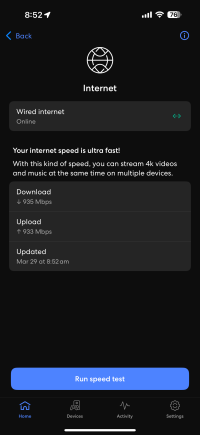

Again, I am finding it hard to fathom with the exceptional 1GB speeds coming into my household (see screenshot above) and two Eeros connected via backhaul (and getting wired speeds of 1GB from each node), that the WiFi output is so bad. I can take a wireless reading a few inches from the Eero satellite with the phone touching it and I can't break 500 Mbps.

Tried that with Eero support within the past two hours and even with one node (the Gateway) active, speeds were not improved.
