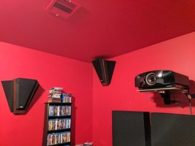

That's the best pair of images I have - it's on a pretty high shelf (which i've currently "rigged" with a tile and irwin clamp to give a broader surface, as the mount is off center).
I'll be building a permanent shelf in the near future, when I find the time.
Images appear blank to me.
