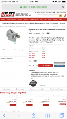

I bought a (used) second Cerwin Vega V12s subwoofer. While the sub was very well taken care of and in really good condition the provided power cord was obviously bought as after-market. While the female plug fit the sub male with no issues, There was a sticker that indicated a part number not associated with the V12s. A computer monitor cord perhaps?
Regardless when I use the after market cord there is a terrible buzz from the sub. When I swap it out with my original cord the buzz goes away. The difference in the cords is the after market has three prongs and the original has two. Of course a grounding issue. But it was a simple fix swapping the cords.
Does anyone know where I can purchase a two-prong male (YP11) to three prong female (YC12) Cord?
