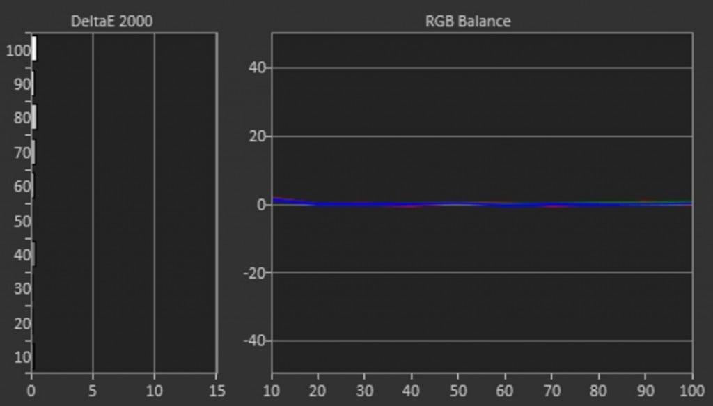

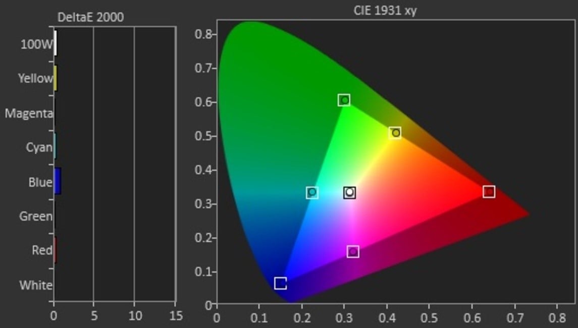

Upon completing unboxing and getting the TV into position in my office, I pulled out my shiny new SpectraCal C6-HDR colorimeter and fired up CalMan 5.6. Calibration was relatively straight forward, though I did struggle initially getting accurate readings. Utilizing the built in white balance controls I was able to get gray scale dialed quite quickly, and followed up with a full CMS calibration.
Out of the box, Movie mode was quite accurate, with DeltaE 2000 measuring between 3 and 5 across the board. Without touch the CMS the out of the box color accuracy was excellent with an average DeltaE of less than 3, which is imperceptible. Gamma was the one area where the set benefited the most from calibration, raising average pre-calibration gamma from 2.13 to 2.2, which better suits a dark viewing environment. Below are the results of the calibration:
[caption id="attachment_1166" align="aligncenter" width="660"]
Grayscale Calibration[/caption]
[caption id="attachment_1167" align="aligncenter" width="638"]
Color calibration chart for Samsung UN55JS9000[/caption]
