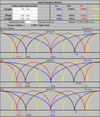

I'm very new to the whole HT scene but I have been frantically researching as I get ready to build. A little background before I ask my question. I will be working with a completely blank slate in the basement so I have nearly every option under the sun available to me. I have a rough idea of my room which will be 24' X 14' X 8.5' I refuse to start building until I have a firm grasp on what I am going to do. I have been researching like mad and I know Screen size is not based off of what space you have but rather where you are siting. During my research I stumbled across a Room Mode calculator by Harman. I entered my room data and here is what the tool spit back at me.
open
So my question is can someone shed a bit more light on this for me. If I am reading and doing it right I should have my seating at about 12' which would be dead center of the room, correct? I plan on having 2 rows of 4 seats with a bar behind the back row of seats. If my above statement is correct do I split the difference between seat locations? Does it matter? Or do I only worry about where the person using the theater all the time(ME:3dglasses:) will be sitting most of the time?
Oh definitely not. You are reading the Harman graphs incorrectly. The place to *avoid* is where you see those troughs/nulls which in your case is at 12 feet. Those cancellations are very hard to fix. Move your seating position to where there are mostly peaks as those can be fixed with equalization. Just a foot or two makes a big difference.
As to who optimize for, definitely for yourself first :). That said, if you use multiple subwoofers and signal processing, you can get a pretty wide sweet spot. See my article here: https://www.audiosciencereview.com/forum/index.php?threads/subwoofer-low-frequency-optimization.15/
