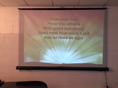

I am trying to help our church. Unknown projector. Suddenly started showing a dim rectangle in the bottom right of the projector display. Not on the laptop display.

Is that rectangle you're talking about running along 2/3 of the bottom of the screen (starting under the letter "S" in "Send forth")?

Welcome! I don't believe the projector is the problem. I would take a look behind the screen.

Nothing behind the screen.
Do you have another [preferably smooth, such as drywall] surface you can temporarily aim the projector at just to quickly rule out anything related to positioning? Also, do you know the make and model of the projector?

It is still there with the lights off and we have been doing the exact same stuff for several years and it just appeared this Sunday- so not sure where it could be from.

Something on the projector lens?
Seems like an odd quirk to be in-projector?

I know nothing about projectors...but it weirdly looks like a reflection of some sort.

I'm not sure where you're going with this. Of course it is. :) If you can't re position the projector as previously suggested, maybe try holding a sheet of white paper in front of it as close as needed to produce a full screen image on the paper. There are only three components here, the projector, the screen and whatever is [or isn't] behind the screen. If you still see the unwanted image on the sheet of paper then the problem is inside the projector. If you don't then it has to be one of the other two components.
Well, actually there's one more possibility. You can try disconnecting the laptop. If the projector can project a blank screen free of this anomaly then the problem could be in the presentation software or the laptop.

It looks to me like image burn-in. Was the a specific slide that was shown on the projector for a long period of time?
