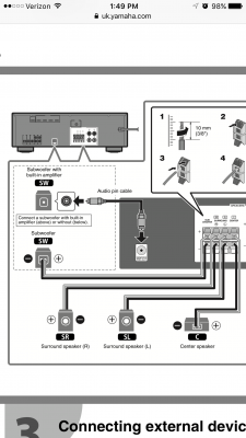

The instruction manual shows an amplified output on the Yamaha for a subwoofer.
Even with the Subwoofer level set to 10 dB and Extra Bass on, the subwoofer hardly seems on, so something seemed wrong.
At the moment, I'm not using the Pre Out Subwoofer RCA connector as I have nothing to plug into it. The subwoofer only has cables that go into the Subwoofer spring clips.

Since your receiver has both speaker connections for a passive subwoofer and a pre-amp output jack for active subwoofers, you can use any subwoofer on (or off) the market.
