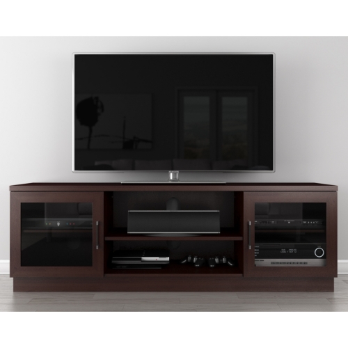

I am going to get a new TV stand/unit, but just for the sake of visualization, let assume it looks similar to this:
Could I put the center speaker where it is position there, and then the left and right speaker, just free standing either side of the television on the unit? do they have to be at a certain height?
Also, say down the line we moved house or remodeled etc., could this set up then be turned into a suround system, if we had the appropriate set up for it?
