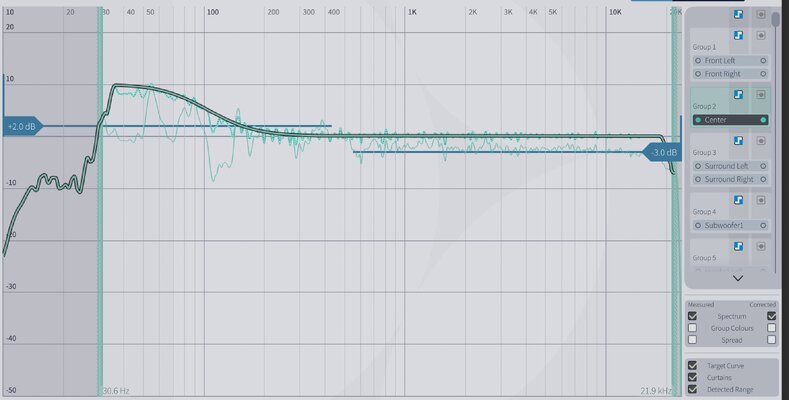

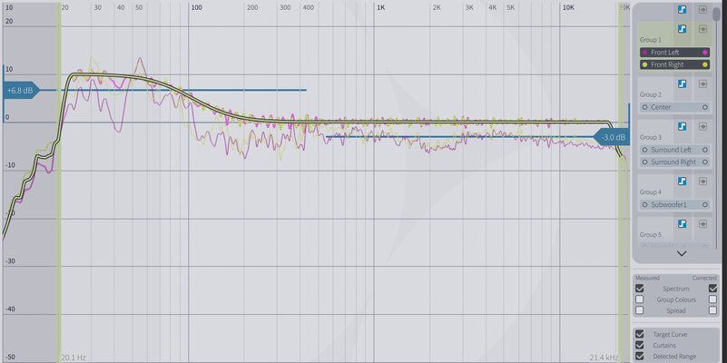

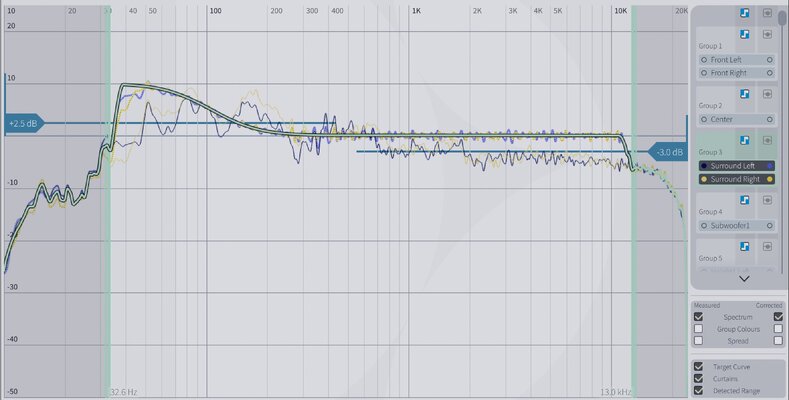

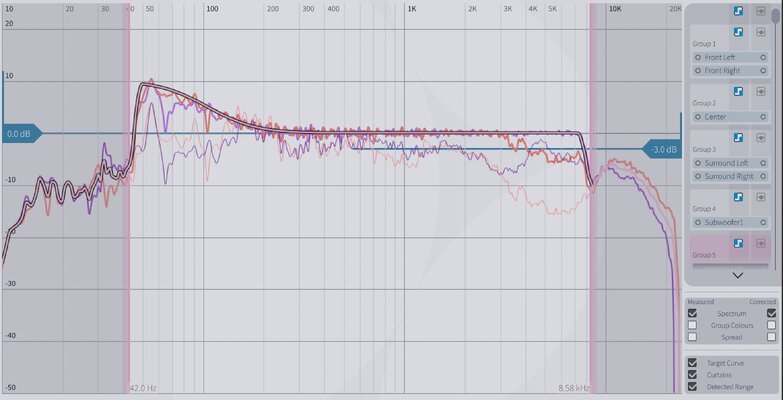

I've been through a whole tornado of all that is Dirac lately. I can't figure out how to get my system to sound as good as my previous ultra budget receiver. The Denon S760H with Audyssey. After running Dirac and listening to a few movies the bass/impact is almost non existent. I can only get a bit if I turn my sub gain all the way up to -4 or more. The rest of my system sounds lifeless and there isn't really any color to it. Very flat sounding...
I have played with my crossover and set up my speaker levels to all match 75dB. I applied a Harmon +10dB bass target curve and still not sounding good...anyone have some suggestions? I will post my Dirac live measurements to show the speaker measurement and correction.
