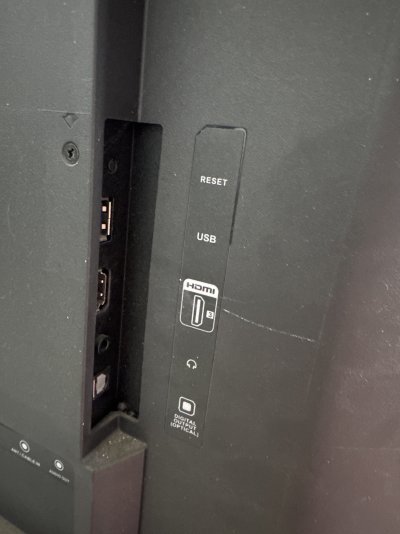

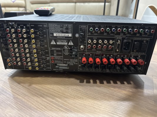

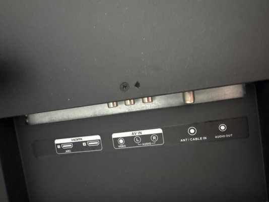

Hello I just got this receiver and have no clue how to set it up or get my tv hooked up. It is a Denon AVR-2805 and a sharp roku TV. Any help would be greatly appreciated.

You can connect one of the digital optical outputs from the TV to a digital optical input on the receiver for audio only. You do not have the proper connections available on the receiver to pass any video between the devices. You will need to upgrade to a more modern receiver for that functionality.
