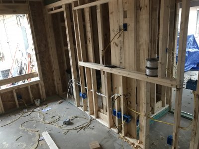

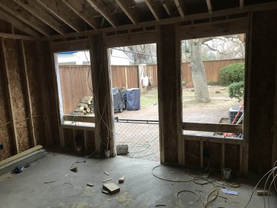

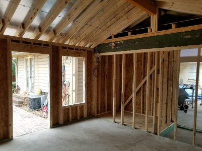

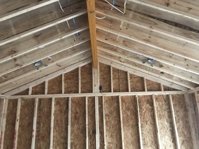

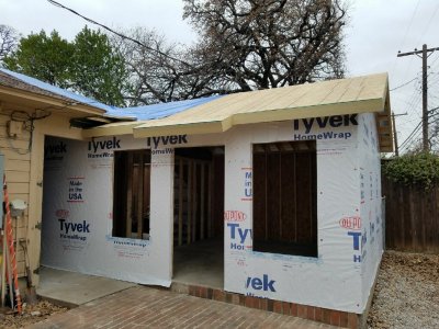

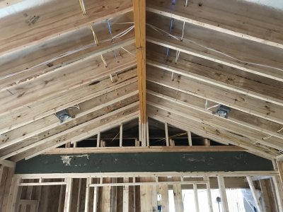

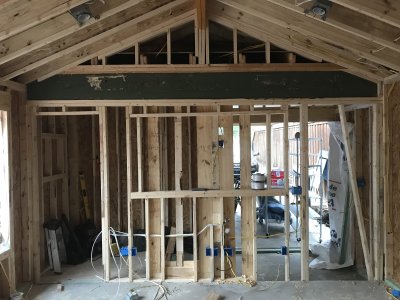

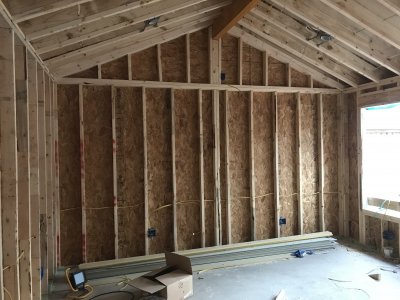

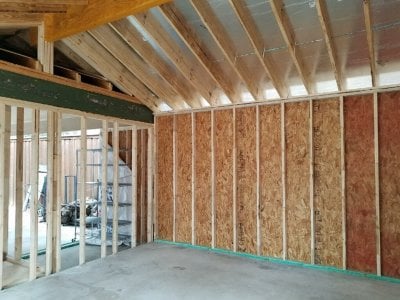

I have been an occasional lurker here and have decided to officially join as I am now building a ground up (slab up) dedicated media room/man cave/teen cave. Since I have not been on the forum much at all in recent years, I am a bit behind in my tech knowledge and thus have some questions and advice requests that I know many of you can assist me with. I am also going to try and attach photos of the current build status.
