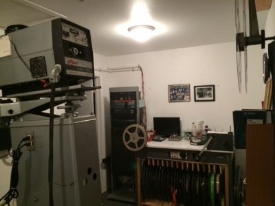

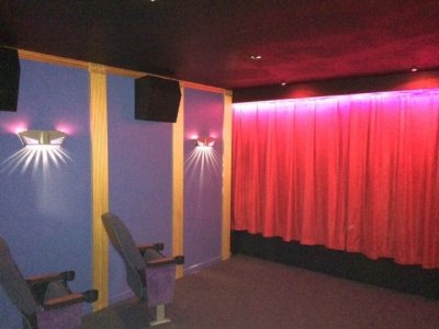

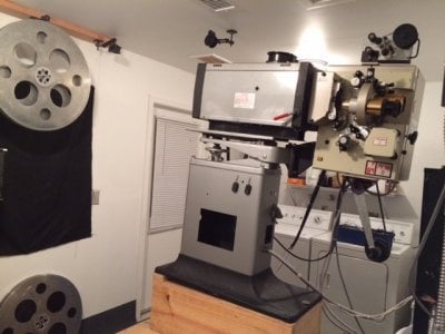

After moving from Atlanta, Ga to Sun City, Ca our home screening room is 99% complete.
It was built on the same design as our other HT except with much higher ceilings, larger projection booth and new JBL surround speakers.
Projection consist of a Kinoton PK-60D 35mm projector, Epson 5010 digital projector ceiling mounted above the projection port window in the rear, Dolby CP650 digital processor, QSC/Smart power amps with all JBL Pro Cinema speakers. I've added a second JBL 18" sub to this install as well. Blu Ray player is an Oppo BD-103.
The screen is a Harkness Silver 3D version 11' X 5', mini-perf. This type screen is required for polarized 3D film viewing.
We have a concession area as well consisting of a restored 1950 Manley theatre size popcorn machine and a theatre style hot dog steamer.

Yeah very nice. I like the way you placed the rollers on the ceiling with spools on the wall. Any chance of a cake platter x3 placed near to PK60D is that the digital sound on the top of the projector.
I guess you can wash the films to keep them clean. :D
What voltage are you using for the lamp house any xenon or are you using a different lamp since its small home cinema. Water cooling for the lamp house.
Any more pictures of the projector looking at the port window.
How many seats any more pictures.
What JBL behind the screen single 15" or duel 15" with horns. How many 8330.
Have you had any snags with CP650 on digital SR-D has it got the EX fitted on the 650.
What films have you got on 35mm.

Hi andysu....lots of questions, all valid. Let me see if I can shed some light.
I actually had a Christie AW3 here when we first moved out to SoCal but it took up too much room so I sold it to a local film collector in the LA area.
No, that's not a digital reader on top. It's a Kelmar Film Cleaner. The digital reader on this Kinoton is in the basement.
The lamphouse is a Strong Super LumeX, theatre style using a 2,000 watt xenon bulb. The power supply is also a Strong which uses 220 volt single phase current.
More pictures coming as I finish the project.
I have a total of 6 nice seats in the screening room. Plenty of room for an additional 6 seats if needed.

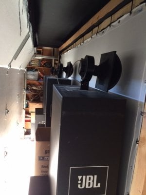

Behind the screen there are 3 JBL 3678's with single horns and 2 JBL 4645C 18" subs. There are a total of 4 JBL 8330 surrounds.
No problems with my CP650 as of yet and no, I don't do EX in my theatre.
I have an across the board collection of film but I don't list the titles on a public board. ;)
Hope I've answered your questions.

Is that the 8330 mkI or mkII models you have as I have x4 myself and x4 more to fit this month.
I have only heard non-sync music being played over the 3678 at boothless cinema at Empire London. They sounded okay with tiny horn on the box and bass mid was nice I could almost smell the cleanness of it. :)
I have heard/felt the 4645C at Empire 1, London they pack a punch. I have single 4645 size in my home THX cinema.

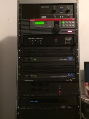

Several more pics from Sun City, Ca.
The speech rack containing all the processing, monitor, amps and OPPO player. A pic of the Epson BD-103 hanging at the back wall and a pic of behind the screen with the left, center and right channel JBL's.
