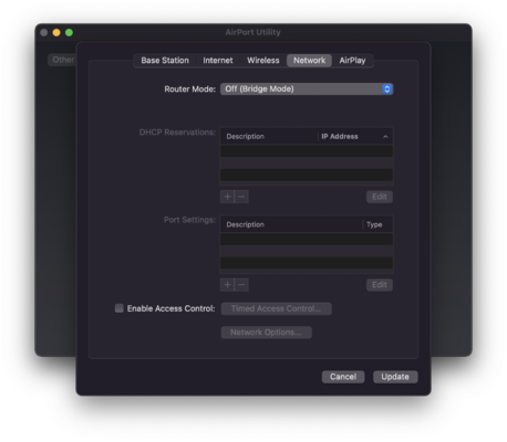

I have the last model AirPort Extreme, which provides 250Mb/s in the main living part of the house. It looks like 250 is the maximum WiFi that router is capable of. Everything in the HT is wired, but it also has that WiFi speed as well as in the living room, which doesn't have anything wired. So, all that should be sufficient for a long time, or until the Apple router dies.
With a slightly older AEBS, I connected an Airport Express and set it to Bridge Mode for a wired extender. Been working fine for about eight years.
I think you'd do basically the same with a new access point.
That brings up an option I hadn't thought about. I could get the AP Dave suggested, with a router, and use the much more capable and powerful AP in the main part of the house, then turn off routing on the AirPort Extreme and use it as an AP in the bedroom part of the house.
