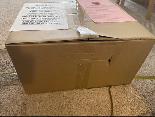

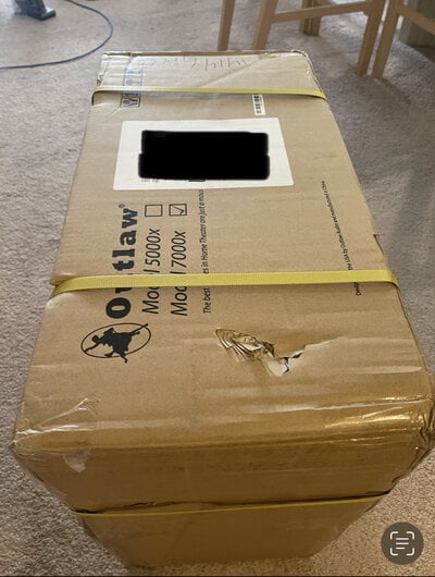

Sadly this unit is being returned and replaced by Outlaw for a new one. First off: major props for Outlaw addressing this quickly and organizing the return (the support trouble ticket indicates I'm getting a new one, not a refurb). I'm not sure whether the hum was caused by a manufacturing defect, or trauma from shipping, but here's a few shots of how it arrived (thanks FEDEX).
Gouge #1 (superficial, they double box)
Gouge #2, this one did puncture through the inner box
Gouge #2, inner box view
However nothing seemed to have contacted with the actual unit. Fit and finish was perfect, no scratches or dents. But a box doesn't look like that without being mistreated. Also the box was standing vertical as you see it in the picture in the mailroom of the building I live in. Didn't even bother to bring it up...which was probably due to either laziness (it does weigh over 60lbs) or, more likely, didn't want a face-to-face the recipient given the condition of the box.
