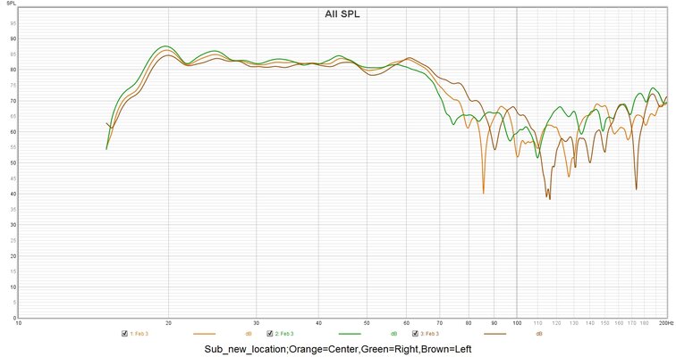

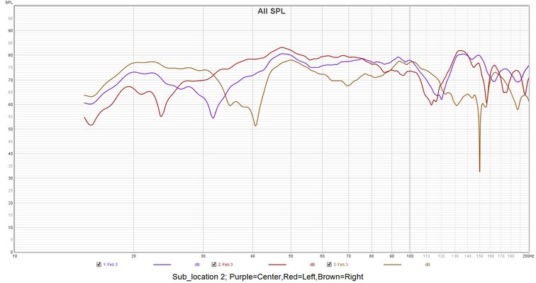

Hi John,
If you have REW and a measurement mic like the UMIK1, you can take measurements to see wwhere your sub gives you the flattest response across the listener area. I dont know what your room looks like but I have a couch pulled 3" from the back wall on mine (the only seating area in the room) and I moved by sub around the room to see which spot gave me the most even response across the couch. I chose this position because it gave me the most even response. The different colors represent the 3 different spots on the couch. sub_at_new_location.jpg
The sub at my old location..
and a couple of other spots

Hi John,
If you have REW and a measurement mic like the UMIK1, you can take measurements to see wwhere your sub gives you the flattest response across the listener area. I dont know what your room looks like but I have a couch pulled 3" from the back wall on mine (the only seating area in the room) and I moved by sub around the room to see which spot gave me the most even response across the couch. I chose this position because it gave me the most even response. The different colors represent the 3 different spots on the couch. View attachment 89449
Thanks for sharing this! I have REW but don't yet have a suitable mic. My problem is I have a pretty large sub, which gives me only about three realistic choices for location. I tried them all some time ago and my ears didn't note any pronounced differences but I realize that means nothing.
I'm thinking of making some major modifications to my room to allow for dual subs at some point but it would involve moving most of my gear to an adjacent room and rack-mounting it, so that's a big project. I'll have to weigh the pros and cons carefully before committing. Meanwhile I'm almost certain I'll be purchasing the Anthem AVM70 [or possibly a used 60] at some point so that should help.
The UMIK-1 is dirt cheap in the US compared to what we Canadians have to pay. You are also correct that your ears and a bass crawl is not all that useful like my graphs show.
