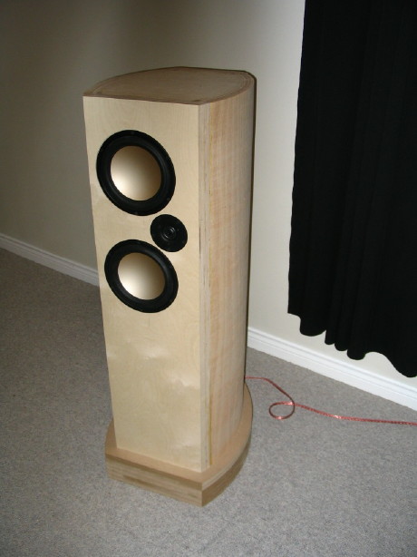

    Below is a pic of a DIY design (not a kit) using the famous Vifa XT-25 ring radiator and 8" alu-magnesium woofers from Hi-Vi Research.
    The raw parts cost excluding cabinets is approx $350/speaker.
    These have enough radiating area and power handling to do a good job in your larger room.
    [​IMG]
    There are several pairs built and lots of info about them available.
    If you're interested shoot me an email and I'll put you in the loop.
    Here's another version, they haven't been veneered yet
    http://www.htguide.com/forum/attachm...achmentid=1205
