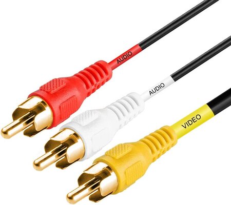

So for VHS tapes you'll likely be stuck connecting your combination DVD/VHS player up via composite (Also known as RCA jacks, which are the cables where the video cable has a yellow jack and your stereo audio has red and white jacks). Coaxial out on your player won't work since your player is going to output it on channel 3 or 4. So even though your new HDTV is likely going to include a coaxial input, HDTV's have dropped analog channel tuners in their circuitry with the end of analog television broadcasting. Coaxial inputs these days only support digital signals and are primarily for those receiving OTA digital broadcasts.
Composite cables:

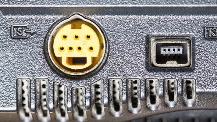

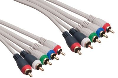

And if your combination player has higher quality S-Video or component outputs, those are likely out as well with your new television. S-Video inputs are long extinct on newer televisions. And component connections are getting to be a very rare offering on new televisions (These look just like RCA/composite cables, but split the video across separate red, green, and blue connectors instead of the singular yellow connector).
Component cables:
S-Video jack on a television (The yellow port):
Sorry for the wall of text, but hopefully it's of some assistance. If nothing else just remember to use HDMI whenever the device offers you the option.
