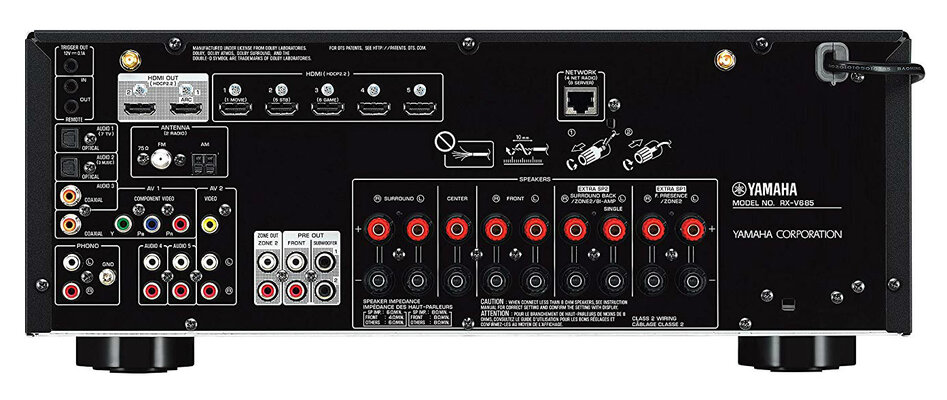

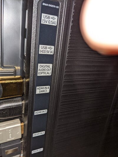

it's been a long time, but I've been struggling with this. The hookups, or something, is not working right.
I suspect that the hdmi out, on the v685, is getting changed, although the remote is not even touched.
Let me revisit this.
What I need to do, in order to take care of the boss ladies of the house, is this.
Not pictured, Harmony hub remote, and roku and samsung dvd player, security camera NVR.
Run the TV and roku, and have the option of using the roku/tv with or without the amp/speakers. Roku remote turns on/off TV, tv sound. -have to use roku remote for this. tv remote not an option for these ladies :(
DVD player, hdmi, can/should use amp/speakers only.
Cameras NVR, hdmi, tv only, no amp needed.
I am suspecting that somehow the amp is doing something, as the harmony will get confused, and it always seems to get stuck on the amp. As the setup was, (which I took the amp out of the loop for now, working solid like that) - well, i don't know. Im just stuck as to what is dropping the signal after getting to the amp, and before the roku, whether the amp is used then or just passed through.
I can program the harmony remote pretty well, unless there's maybe a known code that needs to be passed I don't know about when switching (suspecting that as a possibility).
Seeing the inputs available, maybe someone can suggest something I'm just overlooking. My gut says something about the hdmi and arc doing something.
Possibly something with using the 2 hdmi amp outputs?

With an external receiver there should be only one thing plugged into your TV. The receiver itself. All other inputs should be going into the receiver.

You want all your media sources connected into the receiver's HDMI inputs, not the TV. There should only be 1 HDMI cable connected to the TV (I would use port 4 since it is the ARC port), and the 1st HDMI output of the receiver (it's ARC port).
You will then select a source with the receiver.
This is not strictly necessary, but how you have things connected right now is far more complicated. Run everything into the receiver, leave the TV on HDMI 4, choose whatever you want to watch with the receiver.
