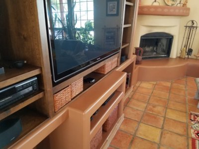

I hate the fact that getting more that 6" for the center channel is possible but very difficult. The 6" is limited by a face frame. Behind the face frame is about 7.25" tall. Depending on the design, you could slide it in, then rotate it into position. Otherwise, I'd really have to work at it. Pain in the ass....
How much room to either side? Well at the floor, basically nothing on the right side as its a raised bench that wraps around the room. To the right of the entertainment center is a fireplace. To the left on the floor, there is room underneath the far left shelf. To the sides at the 44" height, there is pleanty of room for bookshelf speakers to be mounted at the appropriate height.
The sub could go under the shelf on the far left side, but thats where the air handler vent is. If placed on the right side the sub would have to sit 18" off the floor on that bench I mentioned earlier.

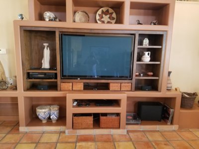

That said, through this thread and others, I have learned it would be a good idea to pull the center speaker forward as much as reasonable to get it out of the cubby. Well, in front of where the center speaker would go is about a 4" shelf, and I can pull out the center speaker a touch. In this case, I'm still limited to 6", but if the speaker has a sloped back like the Polk Audio TSi A4, I can push some of the speaker into the cubby, and some of it will stick out. Doing this gains me just one new option. BUT, you have me thinking now....
Im going to post a photograph in a bit....

Here are some pìctures. I can move the center channel forward of the face frame, but I'm afraid I'm just trading one problem for another. By doing this I'd get about 9" for height, but only 4" for depth.
I will talk to my friend again about other ways to modify the face frame or access to that area.

I see a number of options. The shelf the TV sits on could possibly be notched out. You are correct that some of the Polk speakers, the TSi and Monitors, have a bevel at the back, which would gain you some room.
Regarding the mains, now that I see the pics, I'd try a short pair of stands instead of a shelf. 12" tall looks about right.
