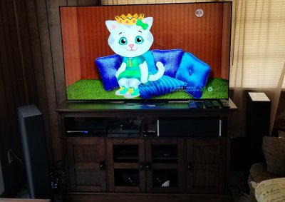

    Thank you so much for your reply. I honestly forgot I made this post till I got a notification in my email.I ended up purchasing the Def Techs after auditioning a few speaker sets including BW and Klipsh. I liked the compact aspect of having the subwoofers in the towers and center. I don't have things cranked very high so neighbors haven't been an issue...yet lol. I am thoroughly pleased with the speakers and have made arrangements to try to get them properly set.
    I purchased a 65" Sony A8F, Marantz 5012, Def Tech 9020 Towers, Def Tech 9040 Center, Karma SS 12 AWG Cable from KnuKonceptz, Sony X-800 4k Player, Audioquest Sky HDMI's, Logitech Harmony Companion Remote

    Glad it works to your satisfaction. I'd have tried to steer you away from something like that too, but since you are happy enjoy em and don't read another review until you are ready to upgrade =)
