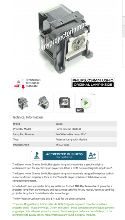

Was it an OEM lamp or 3rd party? Ive seen many new 3rd party lamps actually darker than the worn lamps they were replacing.
OEM from Myprojectorlamps.com.

yup, not epson branded, unless it came in an Epson box.
Please note that I am not convinced it is the lamp that is the problem.
