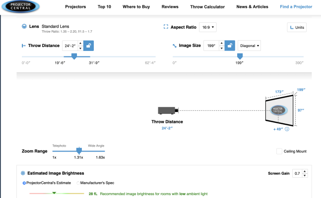

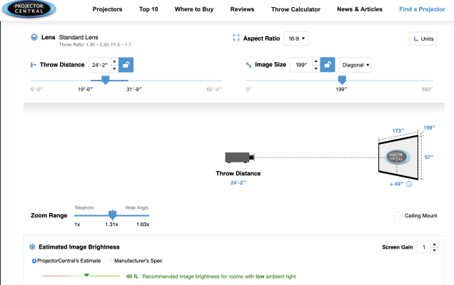

My screen is 13' wide so that's around 195-200" diagonal.
Just not lots and lots of used options for 1080p or 4k in short throw that produce good pi ture for under $700us so I see higher end standard throw with offsets for same or some lower that if that works would rather do that.
A screen that size needs a lot of light to light it up correctly.
A normal JVC, Sony, Epson, or one of the endless cheap DLP projectors online will not have enough light output to properly light up a screen that large.
You will need to consider something like the Epson PowerLite L610U Projector which is 7000 ANSI lumens. It was $3,500 when it was new but these days can be found for under $1,000 on the used market. It is laser based so as long as the laser only has a few thousand hours on it, it should have enough life left to be useful for years to come. When new, with a 1.0 gain screen (normal solid material) it can reach 40ftl of output at that size. Since you will be buying used, it will be more like 30ftl. Perfect place to start.
You don't say what type of screen you have, but a 200" diagonal screen is 8 feet tall, so in most homes that would not leave space for a center channel speaker. So perhaps you are going to use an acoustically transparent screen?
If that is the case, the gain will be more like .7, so you will be on the low end of what is acceptably bright for that screen size even with that projector.
See the attached files for details specific to your screen size and that one projector.
Then, pay close attention to other projector options you consider. If they have less than 7000 ANSI lumens (certified by testing, not just what the manufacturer claims) you will not have enough light for your screen size.
