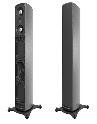

[imgr]http://www.hometheaterforum.com/uploads/gallery/album_37/gallery_383964_37_18476.jpg[/IMGR]The Design
Definitive Technology had a hit on their hands with the 2007 Mythos ST, yet here we stand some seven years later – and technology has come a long way. One of the major changes from the Mythos ST is that the driver design has changed pretty radically. In large part, the changes in the design of the drivers for the Mythos ST-L are due to the addition of a new measurement and analysis method at Definitive Technology’s secret lab in [redacted] called the Klippel System. Sounding appropriately Germanic, the Klippel System utilizes laser mapping, and a host of other advanced technologies with a combination of high and low amplitude signals to better approximate “real world performance” during loudspeaker and transducer development. For the layman, this is just polite Definitive Tech PR speak for “it’s designed to handle the punishment you wackos will dish out on your speakers”. At its most basic level, Klippel analysis is all about eliminating distortion, and distortion is a large part of what makes one speaker sound worse than another.
Some of the interesting design decisions made by Definitive Technology as a result of this system include a parabolic speaker cabinet made of extruded aluminum with ribs for stiffening and a baffle made of Polystone, a very dense mineral rich polymer. This extends to the completely separate driver enclosure which isolates the MTM drivers from the subwoofers, again a decision designed to reduce intermodulation distortion. Another interesting feature of the ST-L is that it is remarkably narrow as shown above, with the total face of the speaker being just fractionally wider than the drivers. This is all in pursuit of lowering diffraction and increasing the ability to image.
