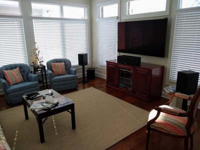

Ok, moving on from the speaker discussion and willing to work on improving what I have (Elac B5.2/C5.2/B5.2). Just installed large rug in front of MLP (see pic below). Hopefully, this will help with any reflections off the hard floor from the L/C/R speakers - TBD. Also, attempting to position side chairs to help with side wall reflections. Clutter on table is strategically placed to diffuse any reflections from that surface (not really ;) ). Will do a trial run tomorrow and continue to work on EQ for dialog. Suggestions are always appreciated.

My 2 cents, your left and right mains seem far apart. Is it possible to move them closer together ? It might improve stereo imaging as well.

They are approx. 10 ft apart and 10 ft from MLP. I can laterally move each about 1 foot and will try that. Thanks
