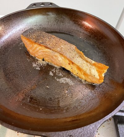

So tonight I tried to throw the Smithey another curveball. Crispy skin steelhead trout, cooked in ghee, seasoned only with kosher salt and pepper. The skin crisped up tremendously, and the end result was awesome.
Second best part (after the taste)? Rinse with hot water and soap-less sponge and it's like I didn't cook anything in it. Meanwhile the seasoning on the finish has smoothed to an almost glass-like feel.
So did I go back to the store and get the small 6" version? You bet I did. Two coats of BuzzyWaxx applied today. Tomorrow, assuming I have time in the morning, I will try cooking my first ever single-serving Dutch Baby in it. Since it's my first attempt, I'll probably botch it But I'm excited to try it out.IMG_2099.jpg
