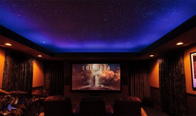

I was looking for ideas on the good old WWW when designing my basement theater. While looking through some projects on here and on Google images, I came across some amazing set ups. Way too amazing. Some home theaters seemed to have 20 foot ceilings, some were as big as the local theater, some looked like a closet with a TV, most were way out of my league. I wanted something designed for a family of 4. Something back to basics, but intriguing and functional.

I do not have seating yet (unless you consider bean bags as a means of theater seating) however the seating will sit about 10' from the screen (THX recomendation). I could have placed the front left and right behind the screen but aesthetics and my OCD for symmetrical spaces pushed me to place them in the corner pillars. I really wanted to do a star ceiling until I saw how much work it was. I had a HVAC trunk that was a big eye soar so I made the best of it by running a false soffit around the room. I dropped the ceiling to about 7'4" to clear any conduit. I placed the equipment in the front of the room, below the screen, so it would be accessible for gaming. It's low and dark and unnoticeable with the lights off. I ran PVC from below the screen to behind the projector in case I break an HDMI cable or want to run something else later. There are 4 ceiling tiles in the back to access any wiring and that can be ran to the utility room next to it.
