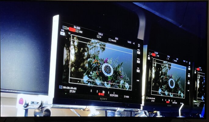

With regards to the "benefits" of the IMAX aspect ratio, especially concerning MCU movies...I think I've come to the conclusion that the way Christopher Nolan uses IMAX scenes in his movie (as a creative/artistic choice) and the way the MCU movies use it are fundamentally different. It seems that MCU movies are using it more to fill the new 1.90 IMAX aspect ratio that theater chains have been implementing to try and entice audiences back into theaters. Nolan wants the extra resolution of true IMAX film, along with the much taller/squarish true IMAX film aspect ratio. I think he used the 1.43:1 AR in many (all?) of his films that use IMAX, and shot "safe" so that it could be reproduced in the "less tall" IMAX showings in theaters.
I was just watching Avengers Endgame the other night (hey, I said I was putting the 7000x through its paces) and on some of the extra features it shows the monitors the Russo Brothers were using while filming endgame. They clearly have two rectangular guides on the monitors that represented the 1.90:1 and 2:35:1 aspect ratio and clearly weren't shooting on IMAX film stock like Nolan does. IMG_1283.jpg
There's a pic I took of it. So for most (all?) of the MCU movies you do get more top and bottom information which can convey information you didn't have before. Check out Vincent Teoh's fantastic video comparison and commentary here:
He also noticed that there's a tone mapping difference in the 1.90 vs. 2.35 versions of Black Panther (the 1.90 version overall is brighter than the 2.35 version, regardless of whether that 2.35 version is the Disney+ or the UHD version).
Going back and forth on multiple titles, the extra top/bottom does occasionally convey cool additional information. For examples there are a few scenes when a character in the foreground is the focus of the scenes and on the 2.35 version you see people standing behind them but obviously are not integral to the shot, and all you see is their torso...but in the 1.90 version you see "oh that's Thor, but he's not saying or doing anything and is out of focus". So could you argue "hey I like knowing that's Thor", sure. But could you also counter-argue that it's really not important to see his face because it's out of focus anyway since he's in the background and also you could tell it was Thor due to the uniform? Also yes.
And I'm sure this is not a universal truth to the MCU movies, but in looking at the Russo films, they clearly are composing with an eye towards 2.35 knowing a large portion of the audience will see it that way in theaters. There is a certain composition to the 2.35 versions, where closeups feel more intimate, and the loss of top/bottom picture information feels less like "I may be missing out on things" and more "I'm focusing in on what's important and what I want the audience to focus in on visually and emotionally.
But even with the Russos that's not necessarily universally true. Vincent Teoh's video has a great example of when Bruce is trying to get Hulk to come out and in the 1.90 version you clearly see him rub his hands together which does add to the comedic effect of the scene (and Mark's performance) which is largely cut off in the 2.35 version.
