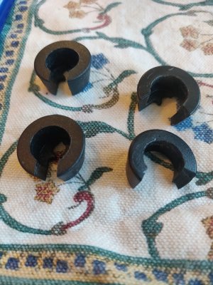

I have just started setting up the system and have encountered a small but annoying problem - I am using the original stands that came with the speakers, the UFS-20. On this stand most of the plastic washers needed to hold the speaker stand in the base have broken.
This means that they are unable to bear the load of the speakers.
For replacements there are extortionately priced replacements on ebay (north of £25 for two!!)
Has anyone come across this type of issue? If so, did you purchase replacements or is there a creative solution which can be used instead which does not cost as much?
Thanks,
RVS
In this case a pic or two might be invaluable

Just managed to take some photos of the part that is broken.
The shaft of the speaker stand fits into one of these plastic shoes which then secures it into the base of the speaker stand.
It is a massive design flaw as it creates a massive weak point in the structure of the stand.
The images show two intact parts and two broken ones!
