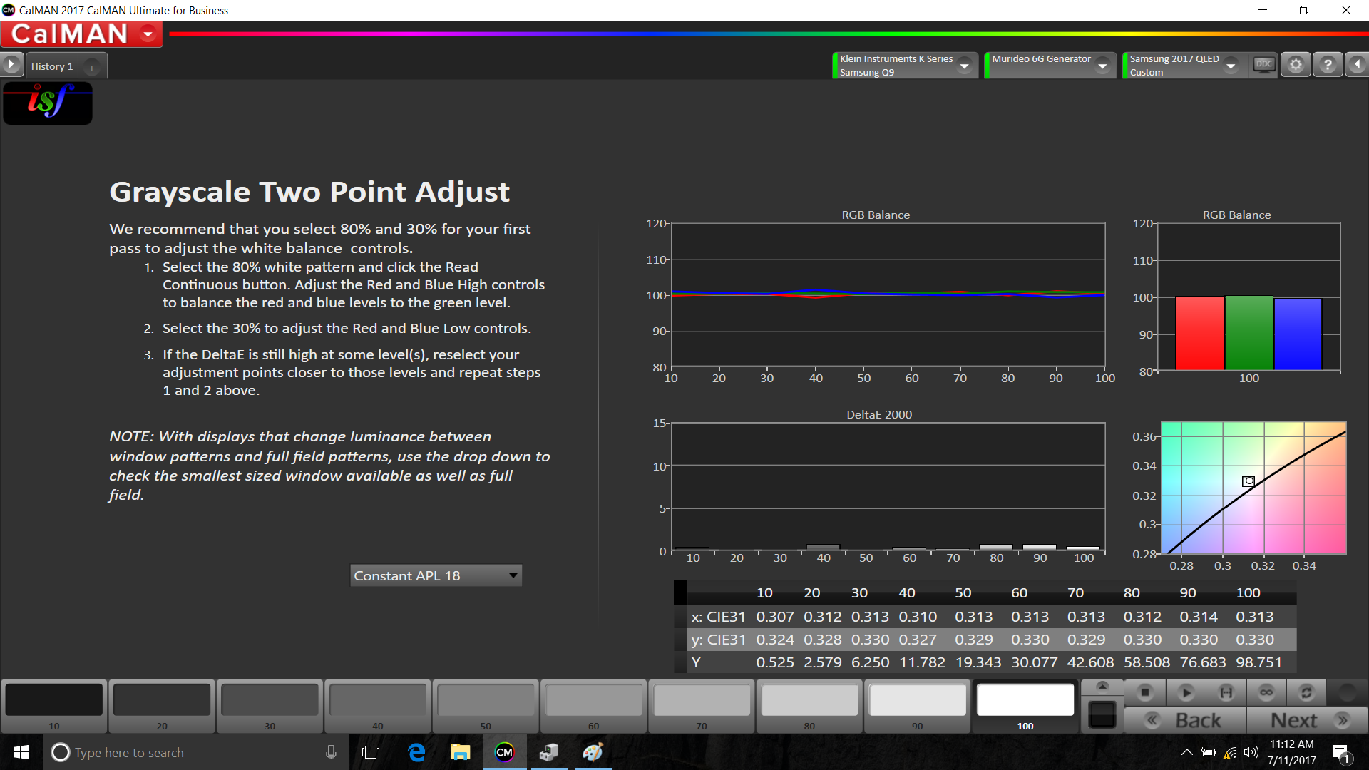

Samsung QN65Q9F LED LCD: The Samsung prices in at $3999, over double the cost of the Vizio. This year Samsung discontinued their local dimming displays, which was unfortunate as both the Sony and Vizio had local dimming. Not having local dimming for HDR content essentially removed the Samsung from the competition for HDR content. The artifacts of having an edge lit display are pretty horrendous compared to local dimming.
I felt that the display performed worse with the patterns and HDR reference material that we were looking at compared to the Vizio. The meters also validated what I was seeing. Unfortunately, I couldn’t recommend this display to anyone.
The color gamut was less accurate than the Vizio.
The gray scale was very good.
The Gamma was slightly better than the Vizio.
