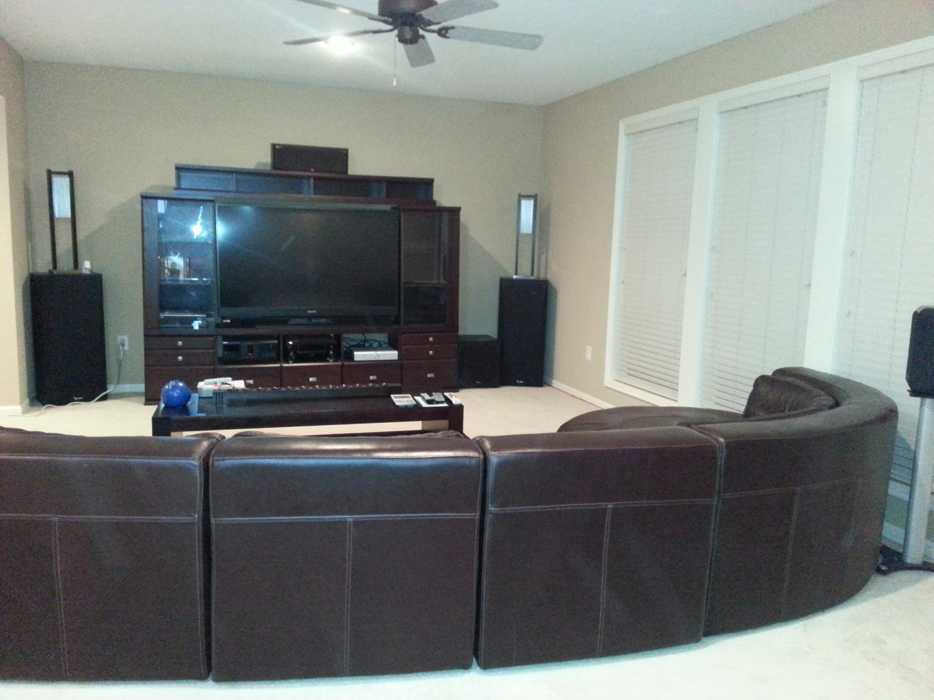

This is a part of my walkout basment that does have windows to the right. of where I would put the screen. They do have blinds and I could always add window treatments to realy darken the room.
I changed my avatar to the picture of the area to give you a better idea of what I'm trying to do.

So...
Based on that picture, are you replacing everything that is already there?
Planning 2 displays and an AT screen?
My "main HT room" has a JVC projector and a 50" Hitachi plasma. I bought the house with an AT screen already there. I had to replace the original projector when it died.
There is no way I'd buy an HD20 when you can get the 6800 for $1000. The HD20 has a "used price" under $500. But, based on your "lack of budget" I'd buy a Mitsubishi DLP RPTV. There is no way I'd attempt to throw $1200 at that room with a projector.

No my 60'' tv in my bedroom is going bad so I would like to put the 65'' from the basement in the bedroom. Sell the enterainment center and put a screen on the wall where it is. Leave the speakers where they are at. That will give me a little over 9ft or if I moved the sub to antoher location. I could gain another 1.5'
