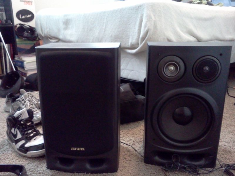

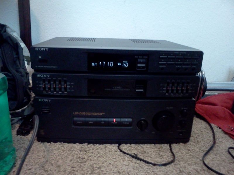

Hi. Im a complete audio/electronics beginner, looking for some help. I picked up this Sony stereo reciever for $20 Posted Image and this pair of Aiwa bookshelf speakers for $8 Posted Image For $5 more I bought an "audio y adapter" at walmart that is supposed to plug my ipod(normal headphone jack) into the reciever(red and white "RCA plugs") I put it all together hoping to have some decent sound for super cheap...but no sound comes out The reciever turns on, and seems to function fine switching between the inputs. It looks like there is little light by the volume knob, which i assume is supposed to turn on when its not muted, but its not lit. thought it might not be a light for all i know. The speakers are a little bit more abused looking, but I would expect them(or at least one of them) to make some sort of noise. I have them plugged into the "crimp" style connectors on the back of the receiver. black wire with white stripe is + and solid black is - right? auxillary cable is plugged into the back of the reciever in the "phono" input location, and reciver is set to "phono". Please, help me out here, I just want to play some music! I pulled the cover off the receiver and all the fuses are good. I dont know where else to look. Thanks in advance!

Post a picture of the back of that Sony rack system... For a few years, Sony's rack systems were "one piece" with a separate CD player and... The BASE of it is where the amp was. This thing may just be a "pre-amp"...which is still a good thing... So, post another pic and we can help.

Here ya go :) Posted Image Posted Image

Yes that has power. You can try the video as well. Phono should work...just sound odd. I'm also going to hedge a bet that the ohm load on those Aiwa might be too low as well...and the Sony is protecting itself. Otherwise...one of the two doesn't work.

Probably not getting a connection, push those red and black tabs in towards where the speaker wire goes into the back of the Sony, they lock the wire in the socket. Also looks like your right wire going into the red block is not going directly into the hole, try again sir.

Ok, thanks for the replies guys, here we go: I tried switching the input and RCA cables to Video, didnt work. The label on the back of the speakers says "6 ohm" and the back of the receiver says " 6 - 16 ohm" so I think Im in the clear there. Type A, im not sure what you are saying about the speaker wire connections? I pushed the speaker wire as far into the terminal hole as it goes, then push the little lever towards the receiver? And that prevents the wire from falling out because it pinches it in there? Thats what I had done before. :confused: They are all in there solid, i just removed a bit too much insulation on a couple of the wires. I wish i knew whether it was the speakers or the reciever not working, i might go pick up another set of cheap speakers at the thrift store and see if they work, since thats the least expensive option, but now im starting to think its the reciever.
