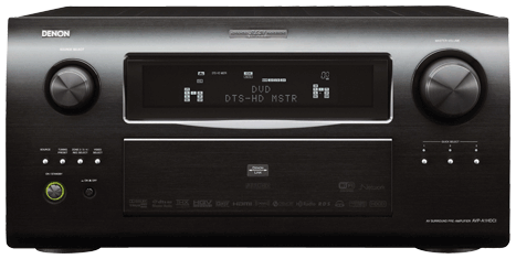

Hi David, thank you for replying to my post.
For me top of the line means something that sounds amazing.
To be honest with you, currently i own a 'HTIB' ONKYO HT-S9100THX
The room is 18' by 15' with leather furniture.
I own a Panasonic Viera TC-P50G10 50 inch.
I have been checking out the Denon AVP-A1HDCI and i was thinking it would be an excellent upgrade to the ONKYO HT-S9100THX head unit.
I do appreciate the other user's answer but yeah i mean seriously, i am not trying to spend over $100k on audio equipment.
I have the budget to get the Denon AVP-A1HDCI if that will be a good move for me?

Just as a note, keep in mind that the AVP-A1HDCI is not a receiver. It's a preamplifier. You'd need to buy an external amp (or amps) to drive your speakers.
If you want an integrated receiver, the top Denon would be the AVR-5308CI(A)

Oh god, i didnt know that. Thank you.
So what would i wanna get? the AVP-A1HDCI or the AVR-5308CI(A)?
And is the AVR-5308CI(A) better than the Top Onkyo - TX-NR906?

Don't overemphasize electronics. The speakers+sub(s) make by far the most difference, start auditioning those first, put as much money into getting the ones you prefer most (a subjective thing, and more expensive is not necessarily going to sound better to you).
And before spending extra multi-thousands on the top-end AVP-A1HD, I would instead look into finding/hiring a custom installer to put in room acoustical treatments and do room EQ like Audyssey Pro on a cheaper receiver like the Denon 4310CI (being newer than the 5308, a lot of the useful features have dropped down and are available for cheaper). That would make infinitely more difference than simply dropping in ultra-expensive electronics to replace your 9100THX receiver.
Don't spend money on wires, that would be worthless. Your TV is fine in terms of picture quality, but it's most probably too small for your seating distance. For good HD viewing you generally want size ~= half your viewing distance, and those with front projector setups tend to go even bigger.
